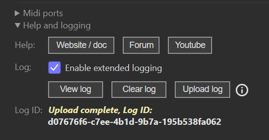

For any button using the Midi plugin in the editor, scroll down to the end and click the little arrow left of the Help and logging text. In the section that opens up, mark the Enable extended logging checkbox. Logging is global for all buttons using the plugin; you can turn logging on/off on any button.
With the buttons, you can view, clear, and upload log files to the Trevliga Spel server.
- The View button opens the plugin log file in a text editor.
- The Clear button clears the plugin log file.
- The Upload button sends both the plugin log file and the Stream Deck log file to the Trevliga Spel server. An ID is assigned to each upload, which is displayed below the buttons. If you have uploaded files previously, the ID from the last upload will appear in the Log ID field.
If the plugin has crashed, that checkbox will not work (even though it might look like it), so you need to do it the hard way: Create an empty file EnableLogging.txt in the plugin folder.

The recommended process for creating a log file is:
Clear the log file.
Enable extended logging.
Quit Stream Deck. (this is important; there are many things I need to see that are only happening when the plugin starts)
In Windows: Right-click the Stream Deck icon in the notification area and select "Quit Stream Deck".
In macOS: Left-click the Stream Deck icon in the menu bar and select "Quit Stream Deck".
Start Stream Deck again.
Trigger the error situation (...but don't do much else to keep the log file focused on the case).
Disable extended logging.
Upload the log file.
Send a description of the problem and the log file ID (important!) either by email or on the forum.
