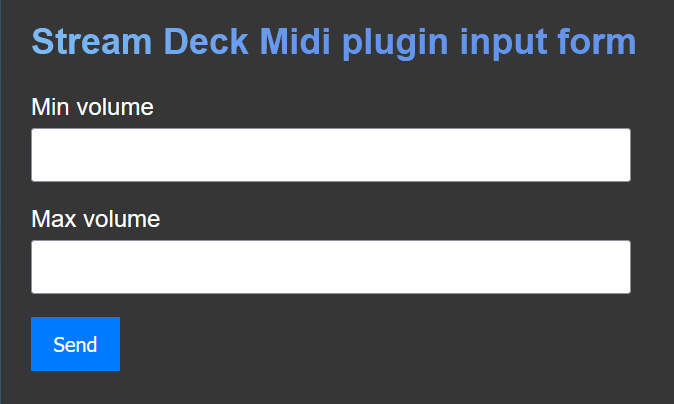

{input:_id_ , _part2Label_ , _part3Label_}
The {input} action will open a web page in a browser, allowing real-time input to the plugin. The information entered on the web page will be sent to the plugin via a deep link.
- _id_ is returned as part1 in the deeplink. This can be utilized in the deeplink event to establish a one-to-one relationship between the input action and the deeplink event. This parameter is not displayed on the web page; the _id_ parameter is merely returned as part1 in the deeplink message.
- _part2Label_ and _part3Label_ are the labels that should be shown for the input fields of part2 and part3 in the returned deeplink message. If you only require an input field for part2, the _part3Label_ parameter should be omitted. If, for any reason, you only need an input field for part3, the _part2Label_ parameter must be set to "".
Example:
[(press){input:Volume,Min volume,Max volume}]
[(deeplink:Volume,*,*){text:#@e_deeplinkpart2#\n#@e_deeplinkpart3#}]
When you press the button/dial, this web page will be displayed in a browser:
For information about how to receive the information, please see the (deeplink) event and the deep linking page.

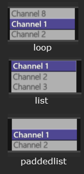

{listoptions:_options_}
With list options, you control how a dial selection list should be displayed and how it responds to dial press and release.
The list options are active "from now on" when a listoptions action is executed; if all lists in a script have the same list options, you can have the listoptions action in an (init) command. All option groups have default values used unless you change them with a listoptions action. You only need to specify the option you want to change; the other options are left as is. Options are defined in separate groups where only one option in the group can be active at a time.
The default options are: {listoptions:paddedlist,usetext,hideexit,press}
List-display options
The list can be displayed as a...
- a loop, wrapping from the last to the first item and vice versa.
- a list, stopping at the first and last item.
- a paddedlist, stopping at the first and last item and displaying an empty line above the first item and below the last item.
The selected item in a list is displayed with white text on a blue background, while the other items are a bit dimmed on a gray background.
For the looped and padded lists, the selected item is always in the center of the display. The unpadded list moves the selection indication to the first and last position at the list endpoints.
