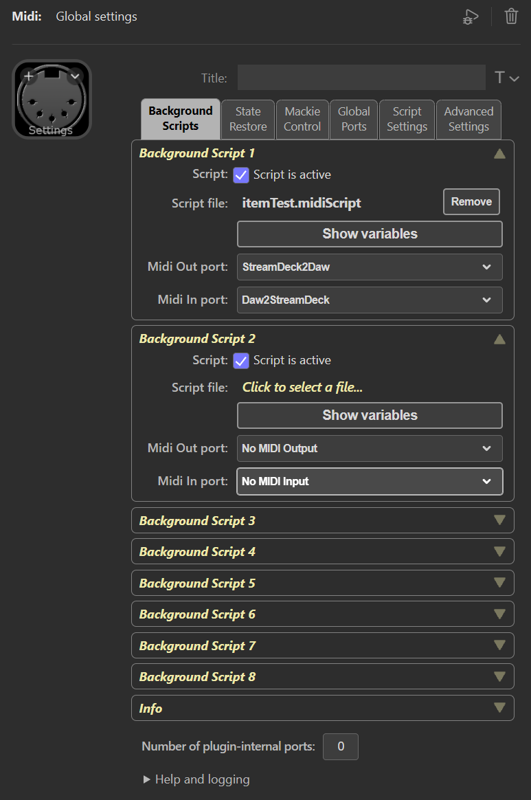

Configuration action
Up to eight background scripts can be run in parallel. For a script instance to be active, a script file must be defined, and the active flag must be set.
Sections with inactive scripts are automatically compressed when you open the action in the editor, but you can expand them by clicking on the header.
Script communication
Background scripts will receive commands on the input port, do their magic and send the result on the output port. If you need bidirectional translation, you need two background scripts: one to translate commands from your buttons and dials and send the result to your daw, and a second script to translate commands from your daw and send the result to your buttons and dials.
