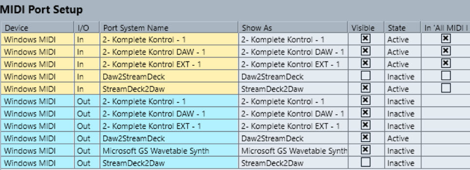

- Midi connections
1. Select the Midi ports created in loopMIDI or Midi Studio.
2. In the Studio - MIDI Port Setup in Cubase, remove both "StreamDeck2Daw" and "Daw2StreamDeck" from "In 'All MIDI In'", otherwise midi input from StreamDeck might cause unexpected results.
3. Also (optional) remove visibility for "In - Daw2StreamDeck" and "Out - StreamDeck2Daw". These ports should never be used in those roles, and hiding them minimizes the risk of unintentially selecting them later on.
4. (optional) import the template bundled with the plugin. This gives you quick start and an idea of what configuration should look like (please see the Installation section for details).
