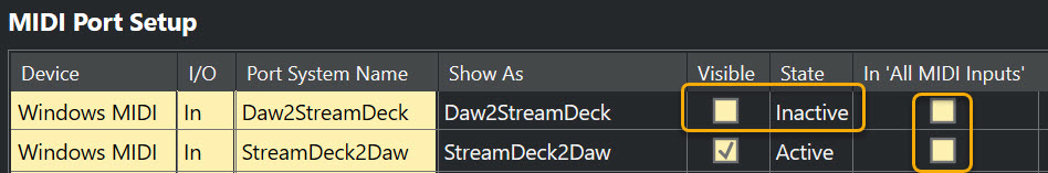

When using Midi commands, Cubase acts weird
There are some known causes of weird behavior in Cubase:
  1. Do not use the same Midi port for input and output.
    You must define one port for the connection from Stream Deck to Cubase and another port for the connection from Cubase to Stream Deck. Using the same port for both directions creates a Midi loop that causes everything to fail.
  2. Do not create multiple Generic Remote commands with the same name (within a single Generic Remote device).
    The "Control Name" in the Generic Remote setup must be unique; otherwise, weird things may happen. The plugin will probably only display the first occurrence in the dropdown, while you may expect the behavior to be according to the last occurrence. The Cubase behavior with duplicates in the list is also somewhat undefined.
  3. Do not create multiple Generic Remote commands with the same channel/CC value (across all used Generic Remote devices).
    When the Stream Deck button is pressed, the plugin will send the defined CC value on the defined Midi channel. If multiple commands are configured with the same channel/CC combination (CC is called "Address" in the Generic Remote editor), they will all execute simultaneously. This may or may not be the expected behavior, but if you have not intentionally configured it this way, it may be a somewhat hard-to-diagnose situation. Please note that the plugin does not send a command to a specific Generic Remote device; it just sends the defined command on the specified channel. If you have multiple Generic Remote devices configured in Cubase, please verify that there are no (unintentional) channel/CC duplicates across all Generic Remote devices. (I recommend using a unique Midi channel for each Generic Remote device).
  4. Do not route remote command ports to tracks.
    If any of the Midi ports used for remote control is routed to midi/instrument tracks, just about anything can happen. Please verify that none of the remote control ports are marked as being in "All MIDI Inputs" in the Midi port setup. I also recommend setting the port Daw2StreamDeck (or however you have named it) as inactivated and invisible as input since the only purpose of the port is to send data to Stream Deck.
