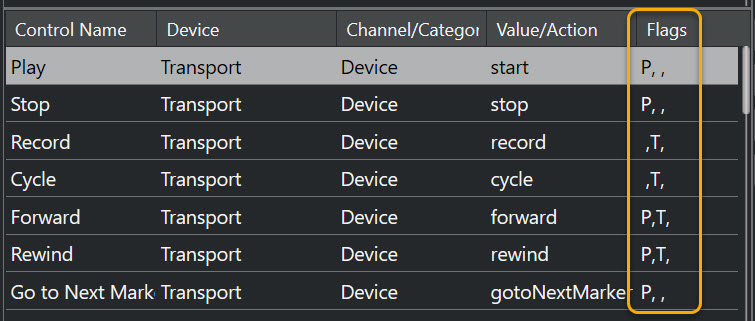

- Button behavior
Stream Deck buttons can be either Push, Toggle or Hold buttons, depending on the configuration in the Generic Remote setup. You cannot set behavior in the Stream Deck editor - it all depends on the Generic Remote configuration.
- Push Button always send an "on" command (e.g. "Play"). (lower flags in the Generic Remote configuration has only "P" selected)
- A Toggle Button toggles between "on" and "off" every other time it is pressed (e.g. "Cycle"). (lower flags has only "T" selected)
- A Hold Button keeps the command "on" while the button is pressed and "off" when the button is released (e.g. "forward" and "rewind"). (lower flags has both "P" and "T" selected)

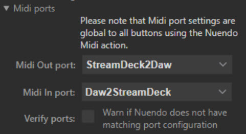

- Midi ports
Prior to version 1.5, Midi ports were fixed to StreamDeck2Daw and Daw2StreamDeck. Starting with version 1.5 these port names are still the default port names but you can change them if needed. The port settings are common to all Nuendo midi buttons on your Stream Deck - if you change for one button it will automatically be changed for all other button. You cannot have different Stream Deck buttons (using the Nuendo plugin) that use different midi ports.
The Verify ports checkbox (also common for all buttons) determine if the plugin should verify that Nuendo is using the matching midi ports in the Generic Remote configuration(s).
- If the box is checked the plugin will verify that the port the Stream Deck is sending on is the same port Nuendo is listening on, and vice versa. If there is a mismatch this will be indicated as a error in the status information.
- If the box is cleared it will not check if port names match but will still warn if the Generic Remote is not connected to any ports at all. If you have a virtual midi port solution that is routing messages (e.g. Bome Midi Translator) you can clear this checkbox to avoid false midi port assignment alerts.
- On Windows Nuendo saves the used port names in the configuration file, and this checkbox is activated by default.
- On MacOS Nuendo saves some numeric reference that probably have some meaning to Nuendo but not to the plugin. The checkbox is disabled by default.
