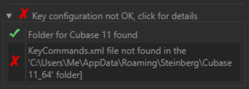

The plugin can't find my Nuendo folder, or uses the wrong Nuendo folder.
The StreamDeck Nuendo plugin by default locates the highest installed Nuendo version and uses key and midi definitions from that version. You can view the status of this search for Nuendo folders if you expand the status list at the bottom of the editor:

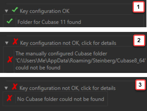

  1. The plugin has located a Nuendo folder for what it determines to be the highest installed version.
  2. You have configured a manual path to the Nuendo folder to use (as described below), but there is something wrong with that path.
  3. The plugin cannot find any Nuendo folder.

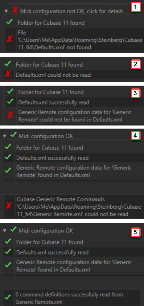

In the Midi action, the Command dropdown is empty.
First, verify that the correct Nuendo folder has been found, and if not - change it as described above.
  1. In the unlikely case, you have just installed Nuendo and haven't made any configuration change in Nuendo; please make some change - any change - to the Nuendo configuration. The configuration file that the plugin reads isn't created until you change the default configuration.
  2. Steinberg saves the Nuendo XML files in a format that is not fully compliant with the XML standard, and in rare cases, this causes the plugin to be unable to read the file. The issues I've seen are all about installed plugins or interfaces with names with characters that need special coding when used in XML files. If you get this problem, please enable extended logging and restart the Stream Deck program. Please send the log file from the plugin folder and the Defaults.xml file from the Nuendo folder to help troubleshoot the cause.
  3. If you have not yet created a Generic Remote device in Nuendo, the plugin cannot (for obvious reasons) read the configuration file for the Generic Remote device. Please create a Generic Remote device in Nuendo.
  4. If the file for the Generic Remote device somehow has become corrupt or deleted, the plugin will fail in reading it. Make a change to the Generic Remote device configuration in Nuendo and exit the configuration window (to update the file).
  5. If all actions to locate and read the Generic Remote configuration are successful, and you still do not have anything in the Commands dropdown, you have probably not yet defined any commands in the Generic Remote setup.

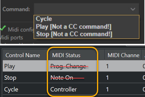

The Midi command dropdown says "Not a CC Command"
The Generic Remote device in Nuendo can be configured to use any Midi protocol type for remote control, but only the Control Change protocol is implemented in the Stream Deck action. If the plugin finds a Generic Remote command defined to use something other than Control Change, it will warn about this with the [Not a CC command] in the dropdown.
Commands using other "MIDI Status" than "Controller" (as it is called in the Generic Remote configuration window) cannot be used by the plugin. If you intend to use the command with Stream Deck, please change the "MIDI Status" to "Controller."

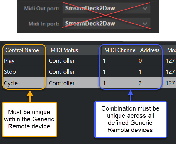

When using Midi commands, Nuendo acts weird
There are some known causes of weird behavior in Nuendo:
  1. Do not use the same Midi port for input and output.
    You must define one port for the connection from Stream Deck to Nuendo and another port for the connection from Nuendo to Stream Deck. Using the same port for both directions creates a Midi loop that causes everything to fail.
  2. Do not create multiple Generic Remote commands with the same name (within a single Generic Remote device).
    The "Control Name" in the Generic Remote setup must be unique; otherwise, weird things may happen. The plugin will probably only display the first occurrence in the dropdown, while you may expect the behavior to be according to the last occurrence. The Nuendo behavior with duplicates in the list is also somewhat undefined.
  3. Do not create multiple Generic Remote commands with the same channel/CC value (across all used Generic Remote devices).

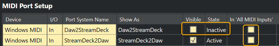

  4. Do not route remote command ports to tracks.
    If any of the Midi ports used for remote control is routed to midi/instrument tracks, just about anything can happen. Please verify that none of the remote control ports are marked as being in "All MIDI Inputs" in the Midi port setup. I also recommend setting the port Daw2StreamDeck (or however you have named it) as inactivated and invisible as input since the only purpose of the port is to send data to Stream Deck.

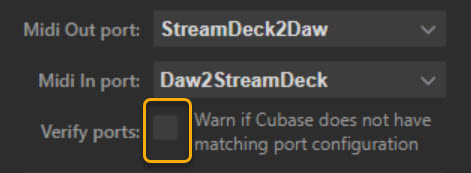

The Midi action warns about the Nuendo port configuration
For some reason, midi port references are stored differently in Nuendo configuration files in Windows and macOS. On Windows, the readable port name is stored, while on macOS, some internal numerical reference is stored.
This makes it impossible for the plugin to verify the used port names in macOS, and to avoid getting warnings about port configuration, you should clear the Verify ports checkbox.

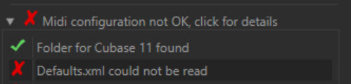

The plugin says that the Defaults.xml file cannot be read, but the file does exist.
Steinberg saves XML files in a format that does not conform to the XML standard and includes characters and character strings that are not allowed. This causes any program that expects well-formed XML (not only the plugin) to have problems reading the files.
The plugin tries to handle this situation and has 250+ invalid strings and characters that it will replace if a format error occurs. Most cases are covered, but there may still be some invalid strings that I haven't encountered yet.
If you have a situation where the plugin can find the Nuendo folder but claims it cannot read the Defaults.xml file (even though it does exist), the file may have some invalid string or character that the plugin is not yet prepared for.
Please send the plugin log file along with the Defaults.xml file to me for troubleshooting.
