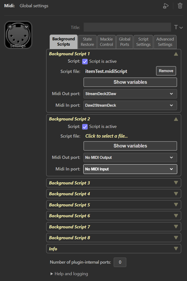

This is where background scripts come into play; a service in the plugin controls them, and they do not require an active script button. There is an action called "Global Settings" that you can load on a button to configure the background scripts, but this action does NOT need to be loaded for the scripts to be active. You can load this action when you need to configure the background scripts and remove it when you're finished.

Up to four background scripts can be run in parallel. For a script instance to be active, a script file must be defined, and the active flag must be set.
Sections with inactive scripts are automatically compressed when you open the action in the editor, but you can expand them by clicking on the header.

Background scripts will receive commands on the input port, do their magic and send the result on the output port. If you need bidirectional translation, you need two background scripts: one to translate commands from your buttons and dials and send the result to your daw, and a second script to translate commands from your daw and send the result to your buttons and dials.
Communication between buttons/dials and background scripts is preferably done using plugin-internal midi ports. These ports are not visible outside the plugin, and commands sent on these ports will not inadvertently interfere with external devices. By default, no plugin-internal ports are available; if required, use the field in the Background Scripts action to set the number of ports required. There is no limit to the number of internal ports you can use, but please be aware that a large number of ports will make the port dropdown lists very long.
