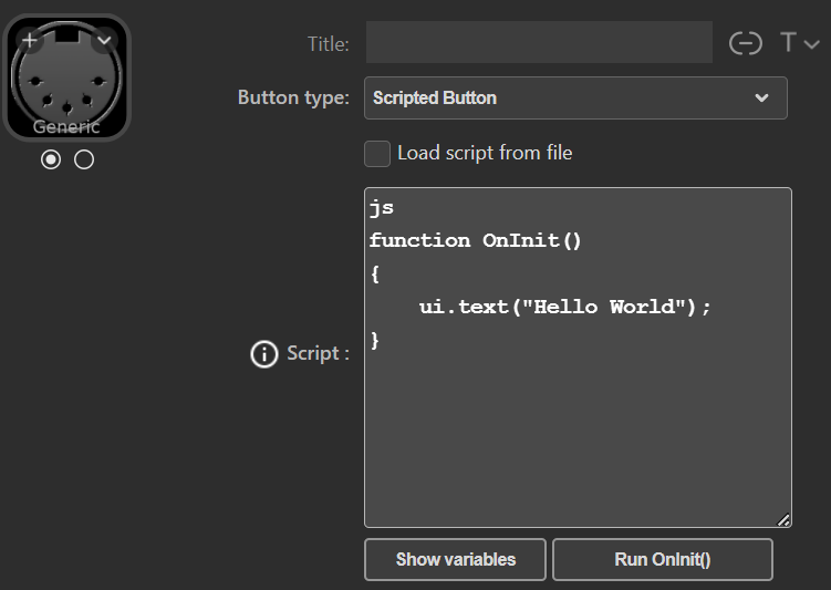

The script can be entered in the Script field or loaded from a file. Since the plugin area in the Stream Deck editor is quite limited, it may be more convenient to edit the script in an external editor.
  • A JavaScript script in the editor must have the text "js" (without apostrophes) as the only text on the first line. Without this JavaScript marker, the plugin will treat the script as a midiScript.
  • A file with the extension ".js" will be treated as JavaScript; all other extensions will be treated as midiScript.

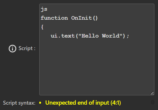

Real-time syntax check
The plugin will perform a syntax check on the script and display a message if anything is wrong.
If you load the script from a file, the syntax check runs immediately when a script change is saved. If you enter the script in the Script field, the plugin will try to avoid interfering with editing by checking the script only when you have not made any changes for three seconds.
If you pause for more than three seconds while entering or editing your script, the plugin will check the syntax and display potential error messages. If you know you are not finished, you can ignore any messages the plugin displays. This delay also means that if you correct an error, the error message will not be removed until three seconds after you have stopped typing.
The syntax check is performed by the JavaScript engine and captures plain JavaScript syntax errors, such as the missing trailing "}" in this example. The position references line:column, where the first JavaScript line = 1. In the example, "Unexpected end of input (4:1)" means that  "}" is expected at line 4, column 1. Messages might also be displayed when the script is executed for issues not detected by simple syntax checks.
